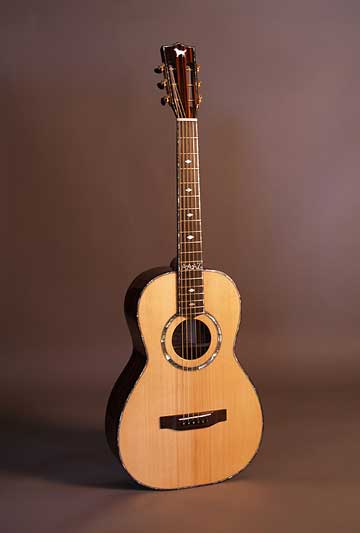

I have built one O size 24.9 scale 12 fret. It is a nice little guitar. Perfect
for a young one.
I made up my own design since I didn't have plans for that scale length
and a 12 fret. It is all a matter of figuring out where the bridge is and
then working it from there. I probably over braced mine though

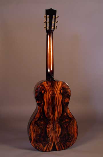

Attached are picts of my 0 size 12 fret 24.9

Andy very nice guitar there.

Andy, WOW, what a beautiful little one!

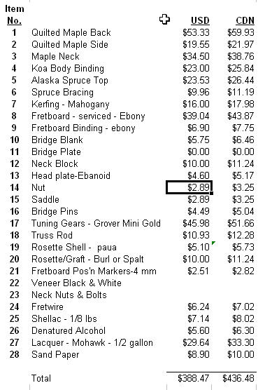

As for cost -- this is the first time I've done an estimate as I was curious as to what it costs to actually build a guitar.
Anthony Z38950.6784837963

Congratulations!    I've had a friend and my brother-in-law tell me they want a guitar, too. But even if I only did it for costs, figuring a case also, I come up with about $500 figuring shop costs into the equation. Course, if I could afford to buy some things in bulk that would drop some.
PostPosted: Mon Aug 21, 2006 7:52 am
Thanks Ron, that's exactly the amount i had in mind prior to make enough money to pay for the wood that i'll need for a next build so $500 to cover for the costs and $200 as wood money sounds fair, i might inlay the girl's name on the fretboard also!

WOW Andy, where did you get that beautiful wood?

I got that Zoot from LMI (Macassar Ebony)
